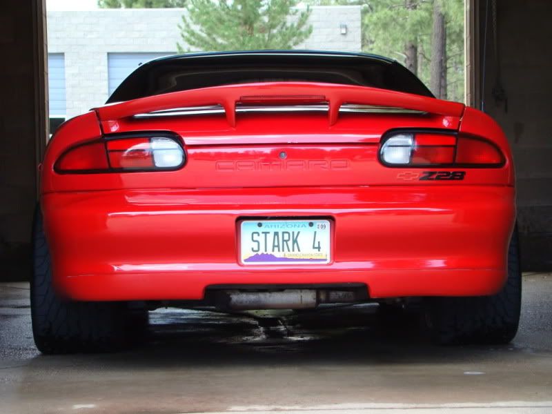

this guy is running 335/30/18's.:hail:
http://i237.photobucket.com/albums/f...hipPics372.jpg
That just looks poor i bet it rides the same way......clean car though
I do like the tail lights on the red car tho...
*is in love with that red Z*
i think it looks cheep cus its missing the CME
my god thats alot of tire!!!

i wanted to put a 325 wide tire on mine but as you can see in my sig, with the wrong backspacing im stuck with these 275's. i want to look like that red car. but with a mini-tub and the tires in the fender good.
