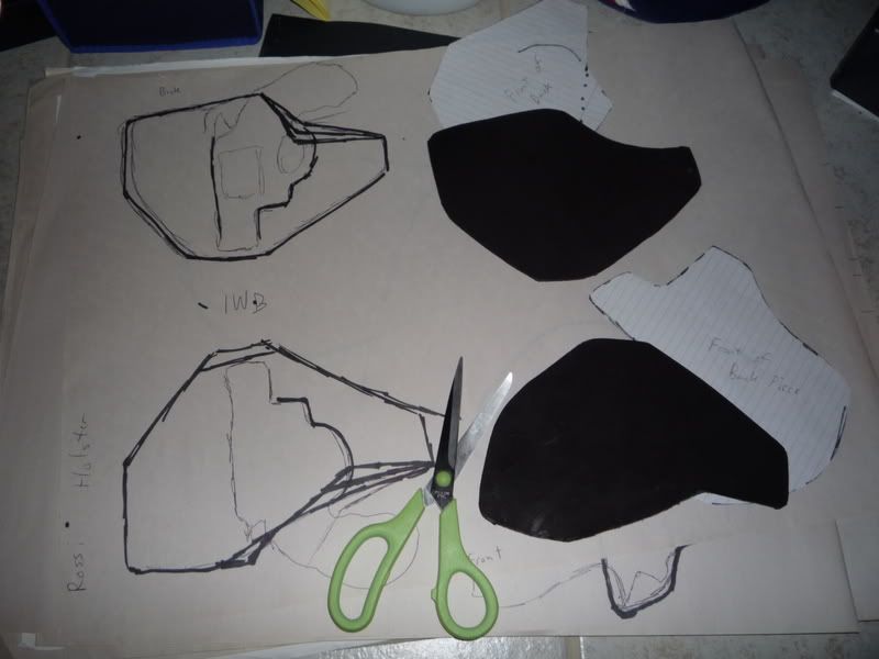

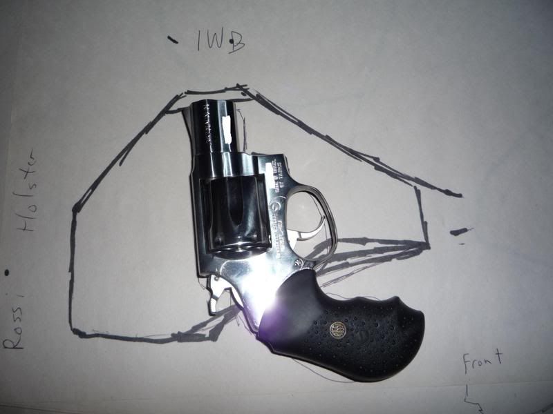

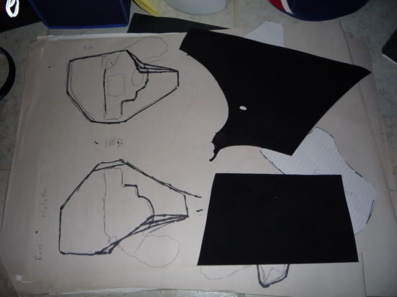

Then I got my new gun and traced out a raw idea of how I want my holster to look.
http://i47.photobucket.com/albums/f1...s/P1020428.jpg
So I got some appropriately sized pieces, I got some black dyed pieces.
http://i47.photobucket.com/albums/f1...s/P1020431.jpg
Then I cut the leather to shape with some sturdy and sharp scissors
http://i47.photobucket.com/albums/f1...s/P1020433.jpg

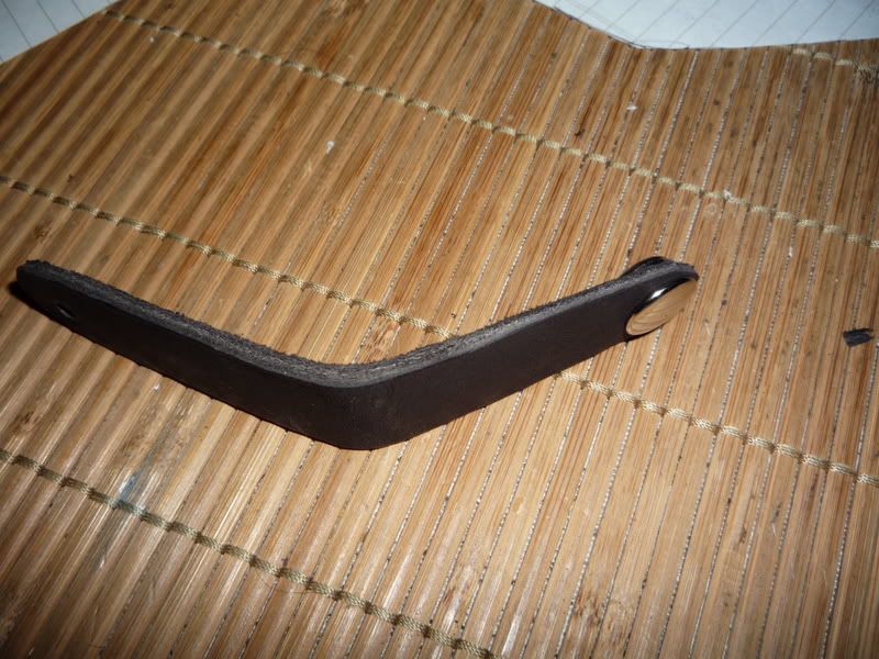

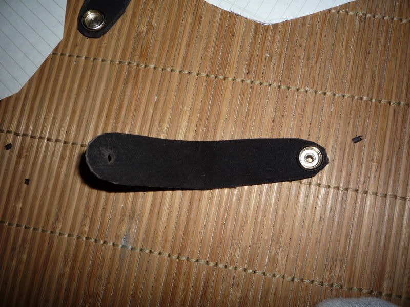

I then made the belt loop snaps, I cut them (here was my first mistake, I didnt account for shrinkage and the loops almost shrank too much to use) to proper length and made the holes for the snaps
http://i47.photobucket.com/albums/f1...s/P1020437.jpg
http://i47.photobucket.com/albums/f1...s/P1020438.jpg

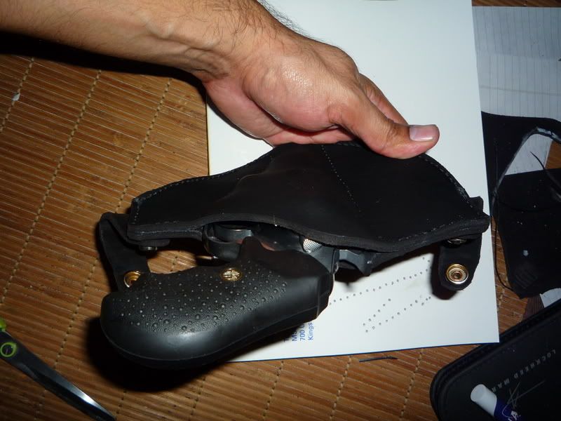

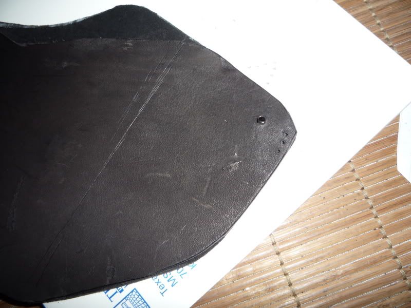

So first thing in the body of the holster was the put the backside of the snaps installed in the front side of the front piece
http://i47.photobucket.com/albums/f1...s/P1020444.jpg

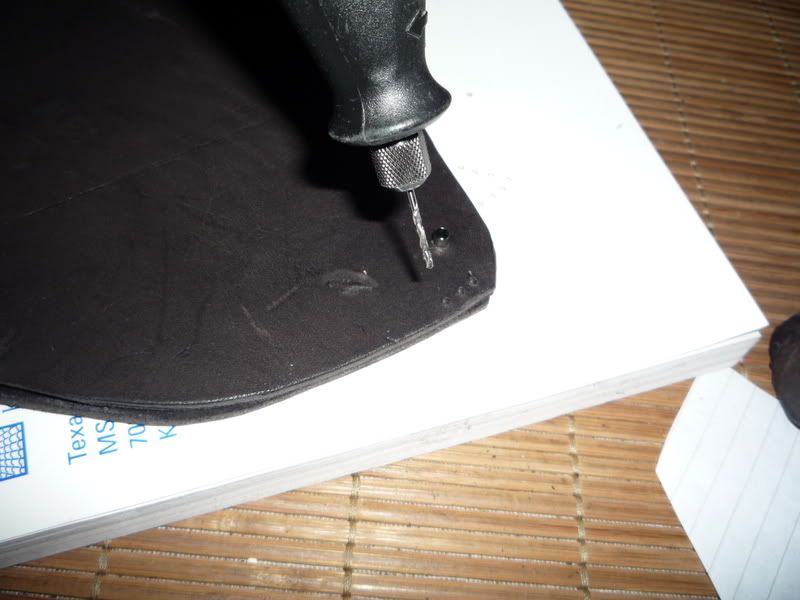

So then I put the two half's together and then begin to drill the holes for the thread
http://i47.photobucket.com/albums/f1...s/P1020445.jpg

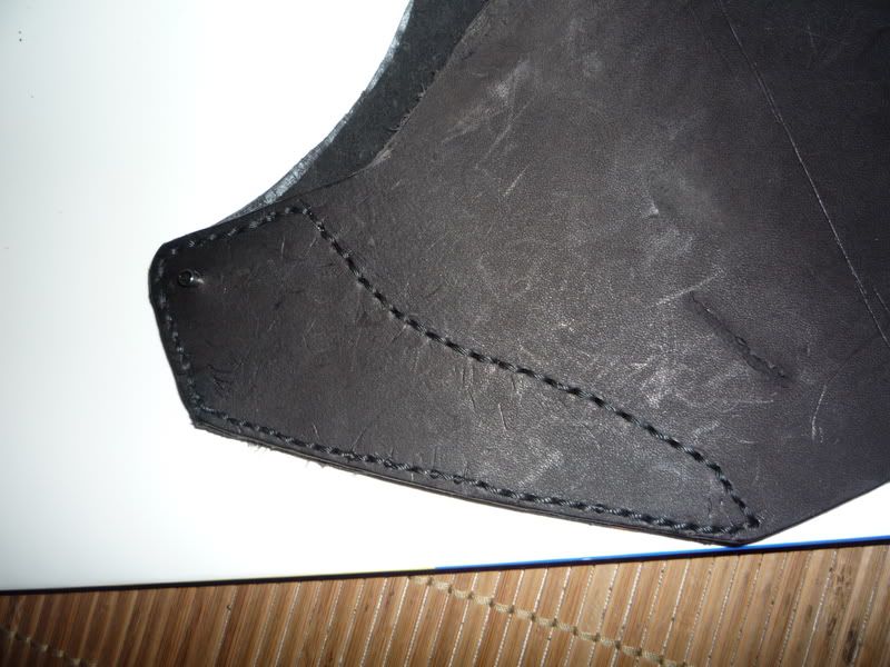

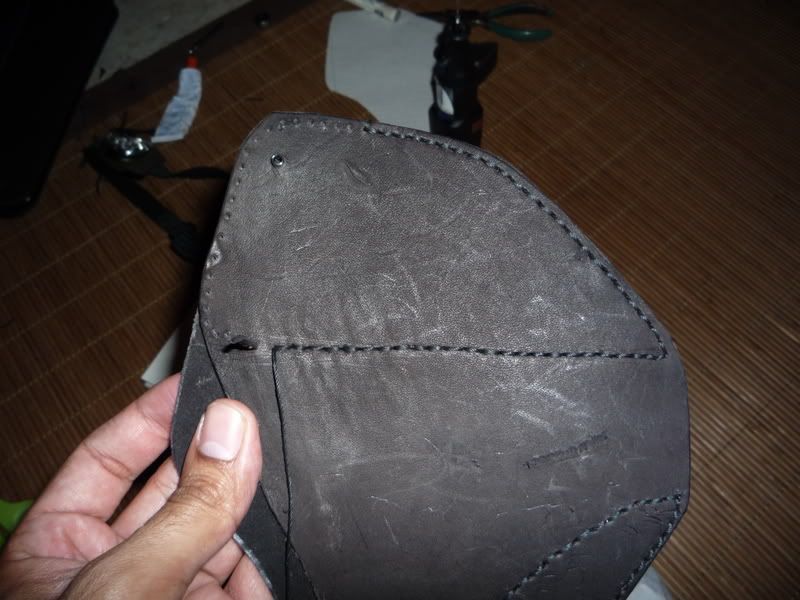

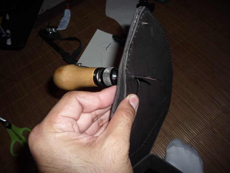

So then I began to sew, yea its kinda girly, but I was making a gun holster for a .357 magnum, so it evened out, haha
http://i47.photobucket.com/albums/f1...s/P1020450.jpg
http://i47.photobucket.com/albums/f1...s/P1020451.jpg
http://i47.photobucket.com/albums/f1...s/P1020443.jpg
Here is the sewed and pre-boiled holster
http://i47.photobucket.com/albums/f1...s/P1020452.jpg

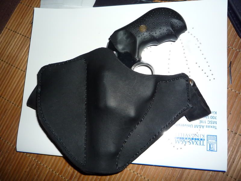

So what you do next is scary, You get a big pot and put enough water in there so the whole gun and holster will be submerged.
Then you boil the water and put your gun and the holster in the hot water (tip: put a cord on the handle of the gun so you can pull the gun and holster out)

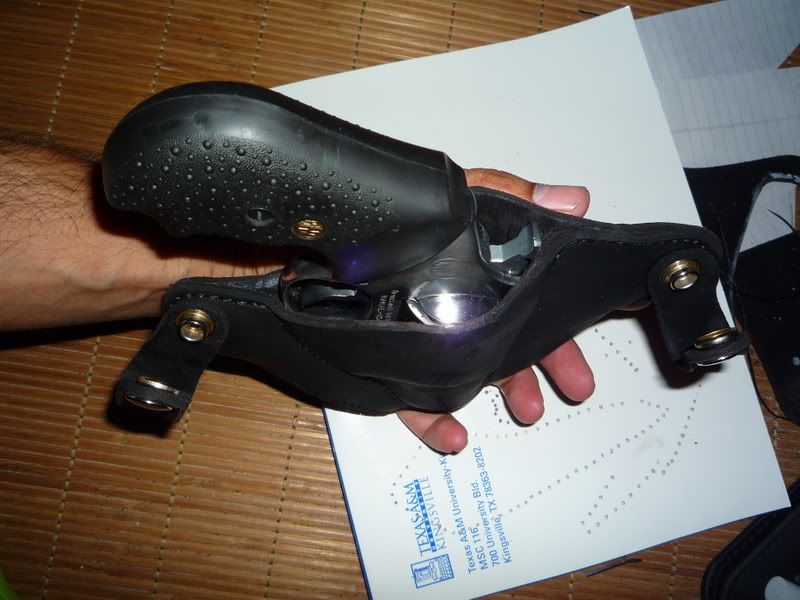

So after you boil the holster for about 10 minutes, pull it out and mold the holster the way you want, the leather will shrink and press on the gun, but make sure to push on it in certain areas to make sure the gun cant fall out easily from the holster.
Then after this dunk it in cold water, then take it out and wait for it to dry.
Now you have a holster that can be made for around 10 bucks.
For the leather the snaps the thread the sewing kit Everything was 30 dollars, and with all this you can probably make 4 holsters depending on the size.

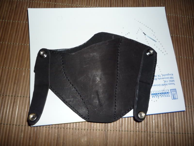

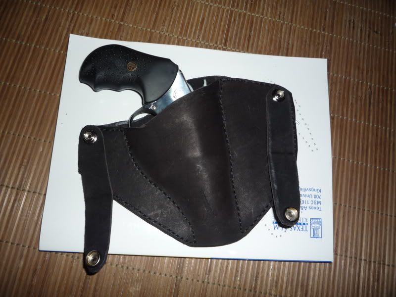

So here is the final product, I am thinking about buffing it to a high sheen.
http://i47.photobucket.com/albums/f1...s/P1020454.jpg
http://i47.photobucket.com/albums/f1...s/P1020470.jpg
http://i47.photobucket.com/albums/f1...s/P1020471.jpg
http://i47.photobucket.com/albums/f1...s/P1020472.jpg
