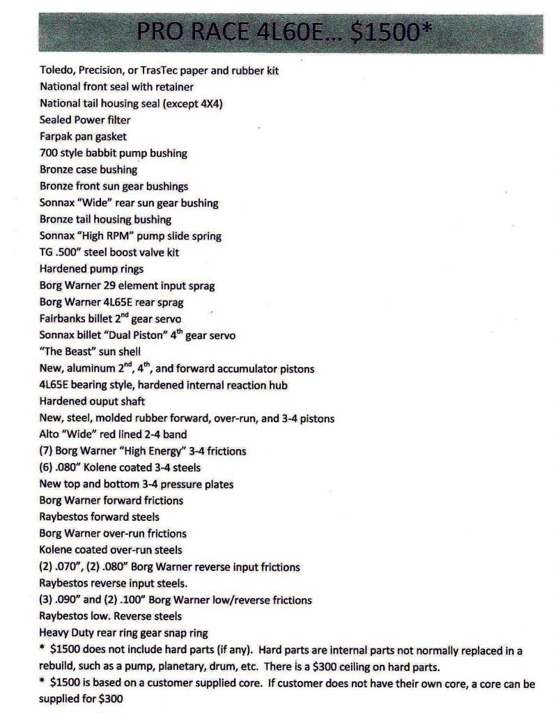

ok thanks i think im just gonna do a rebuild just because its easier on the wallet but i dont think ill get the 4l80e but i was planning on doing a rebuilt with this monster in a box by monster trannys tell me what yall think about the kit
Also i bought the car with the built tranny the guy said it was built by a local tranny shop and they did a bad job so im thinking about just buyin this kit and take it to this well kno shop where i live at. thanks on the input keep it coming thanks
http://www.monstertrans.com/store/pr...93%252d97.html)
