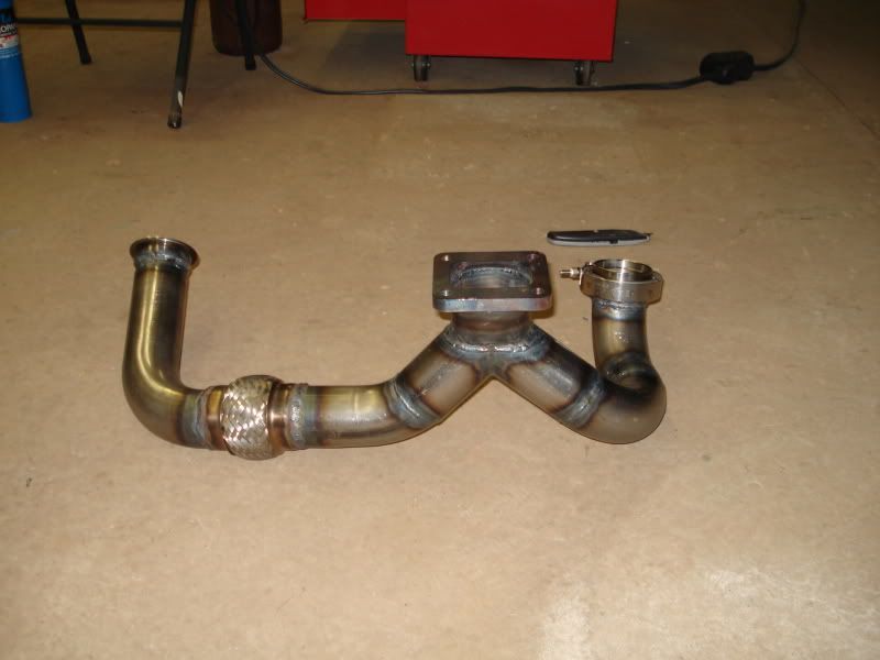

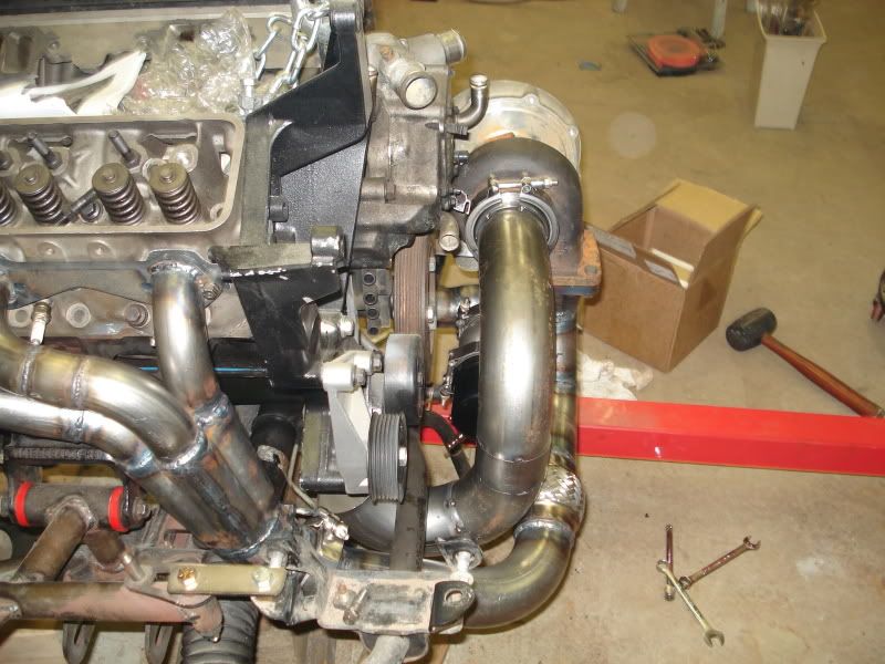

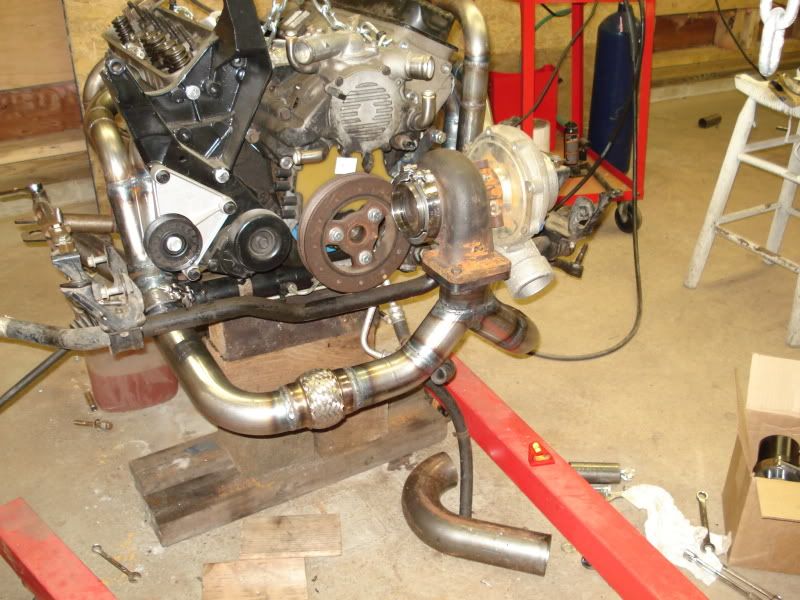

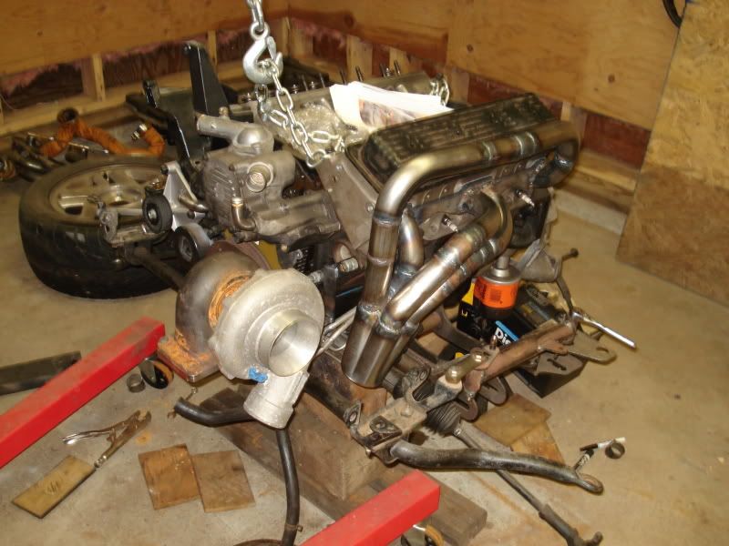

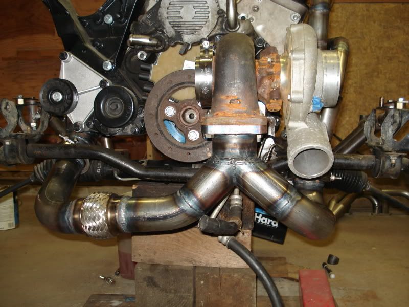

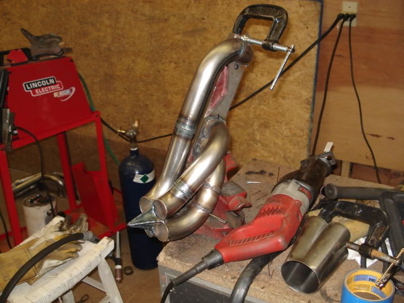

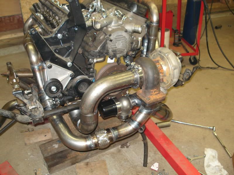

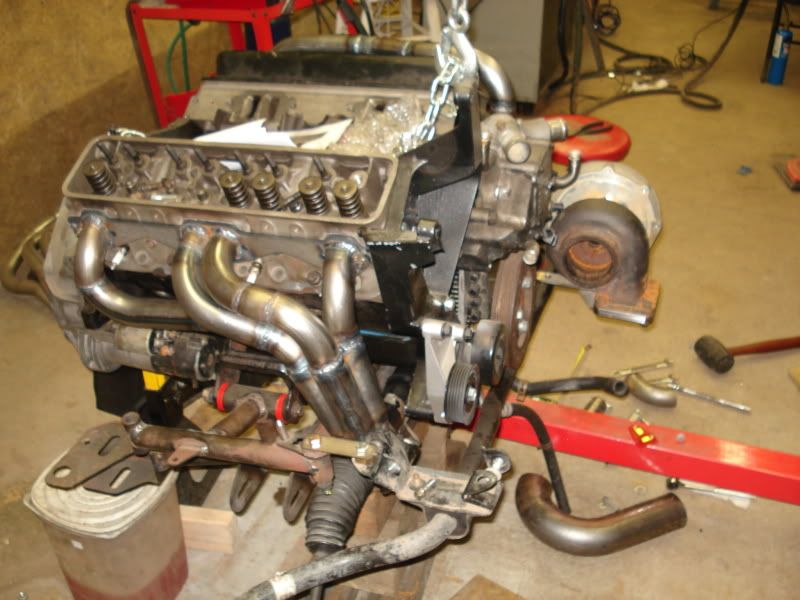

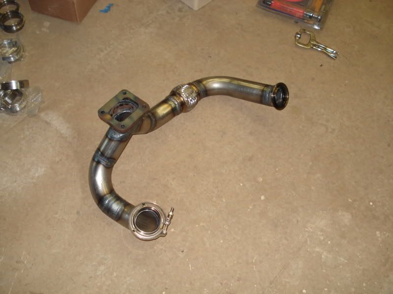

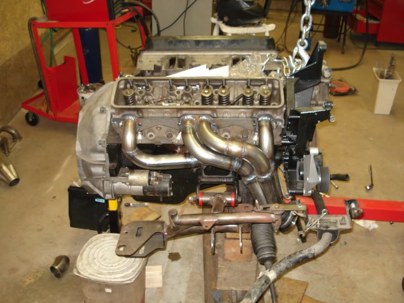

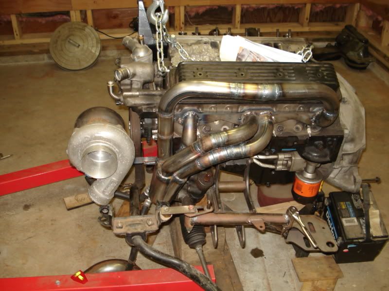

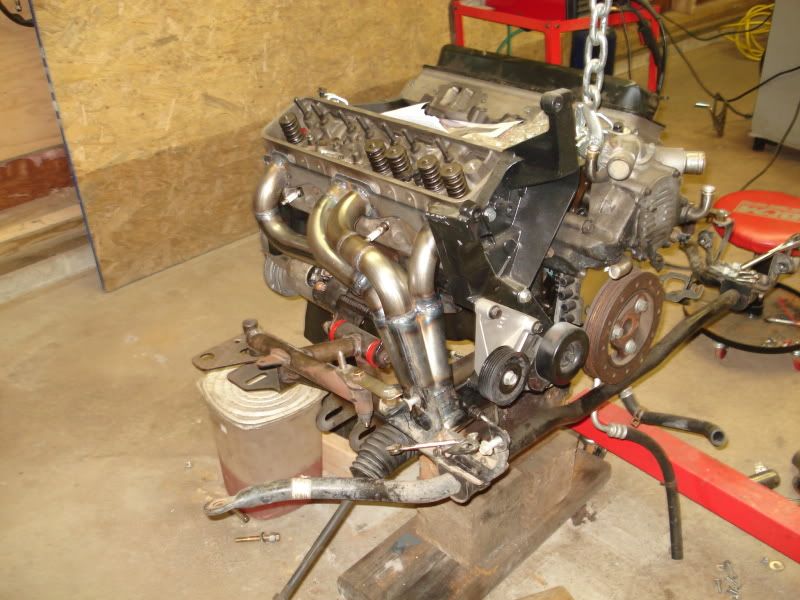

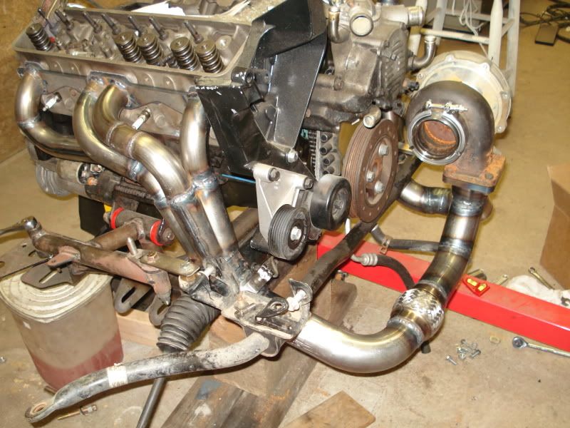

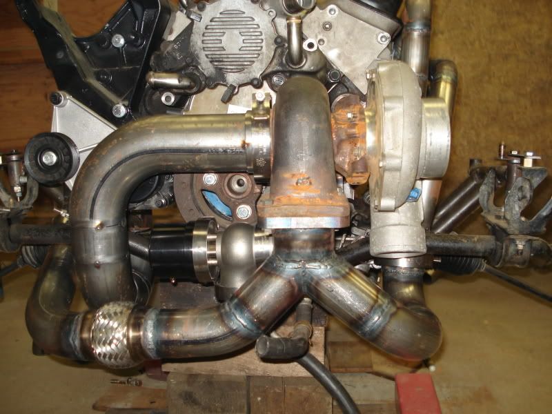

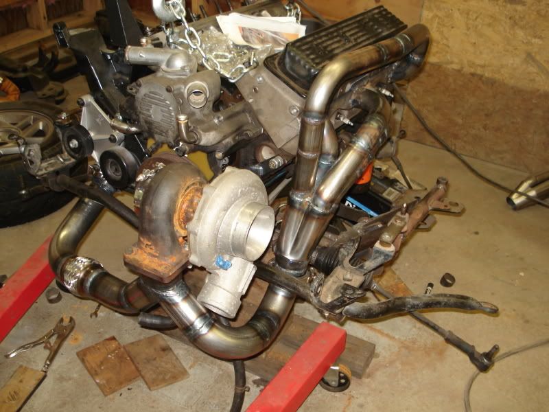

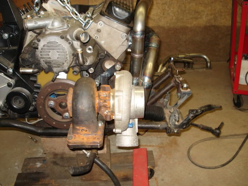

While waiting for stainless pipe for a customer's build, I started building a new kit for the shop car. It will consist of the following:
Custom 1.75" primary tube headers
2.5" merge w/ 3" DP
PT76GTS
50Rmm JGS wastegate
60mm JGS BOV
4" IC
3" Black powder coated pipes
Kit will be finished around the stock K
http://i45.photobucket.com/albums/f9...r/DSC02077.jpg
http://i45.photobucket.com/albums/f9...r/DSC02079.jpg
http://i45.photobucket.com/albums/f9...r/DSC02080.jpg
http://i45.photobucket.com/albums/f9...r/DSC02086.jpg
http://i45.photobucket.com/albums/f9...r/DSC02087.jpg
http://i45.photobucket.com/albums/f9...r/DSC02088.jpg
