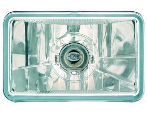

Purchased Hella free form housings and blinglights fog lights.
Hella uses an H4 bulb and the fogs are H3. Both will be using Osram Night Breaker bulbs. I'm usually a Sylvania Silverstar Ultra guy, but these were cheaper and Osram owns Sylvania. Based on the reviews, they should be fine. I could also run HID's in them, but I'd rather rock BLS's sweet projector housings. These will more than exceed my needs for now. Thanks to those who recommended them.
BTW- the housings are clean and the glass is much thicker than I thought. Better than OEM for sure, and I mean both headlights and fogs.
Hmm. I recall the free forms having a clear front lens. They should outperform the stockers regardless.
I almost went with the zxe's, but they were a little ricey and like double what the Night Breakers cost.
As for the headlights, they are NOT free form. I had it stuck in my brain when I typed this up earlier, but they were cheaper, had solid reviews, and came with adapters. Whether they work or not will be a different story.
These are free forms:
http://www.dirtyparts.com/products/008888101.jpg
