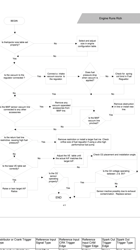

Man there are so many tables in this dfi program and everything is done in realtime. To say I'm overwhelmed is an understatement. The biggest issue I see now is my injector pulse width. Accel recommends not going lower than 1.7 ms and the lowest idle I can obtain without inducing a roll is 1000. While I don't mind this the pulse width sits at 1.3-1.5 here and once put in gear it dies. I also noticed pressing the brake makes it go wonky ( I'm assuming because of the vacuum booster). It holds vacuum with the engine shut off so I don't think its bad. Currently I have a stock fuel pressure regulator on so I might try this adjustable one I got from Larry and turn the pressure down a bit and see if that helps the pulse width and idle.
Well that ain't gonna work. I wasn't clear on what those fmu's do. They only raise the pressure under boost, nothing under vacuum. I've done a lot of reading on it and guys are able to get these 60# injectors to idle fine at lower pulse width so I'm just going to have to keep messing with it. @JPack do you have any idle tuning tips for me??
Map sensor on its own good source of vac? No kinks cracks etc? Fpr vac source in good location? Played with target afr @ idle points? What map do you have on now? 02 feedback good and is it in ideal location? How much vac is the car pulling at idle? When on the gas a little bit does the brake peddle get hard or soft? How about at idle? Fuel pressure with no vac applied is what? With applied and blip of throttle what does it do?
Thats where I would start. Make sure all your ducks are in a row and lets go from there.
Found the page I was looking for in the manual.
http://i3.photobucket.com/albums/y77...psdfccac5b.png
Map sensor is in stock location on intake, I've read that putting it on its own 10" long vacuum line will help dampen the pulsations that make it go into a hunting pattern, I may need to do that.
Fpr vac source is stock location, hose in good shape.
I have not messed with target AFR points. It calls for around 14.5:1 and the wideband is reporting around 11:1. While closed loop fueling the correction is maxed on rich.
2 bar map
Wideband o2 is new and about 4" after the collector. All joints are welded.
Vacuum at idle, dfi is reporting -5 to -6 psi from map sensor. My boost/vacuum gauge reads a steady 17"
Brake pedal seems firm, I'll have to pay a little more attention to it tomorrow.
Fuel pressure WAS around 45psi at idle with vacuum plugged in. Hard to read the gauge because it fluctuated a lot. I haven't checked it with no vacuum applied. I might go do that now.
I'm running this 400lph pump and it is hotwired. I have 1/2" supply and 3/8 return. BUT the stock gn pickup has a tank return size of 5/16"-1/4" iirc.
Damn that thing seems louder at night for some reason.
Ok, key on engine off it pressurizes to 55 psi. After the pump stops running it drops to 40psi
Startup with vacuum applied it fluctuates from 55-45 rapidly. With vacuum removed it fluctuates from 55-50psi. Blipping the throttle doesn't seem to change pressure any.
I'm running a stock fpr. With those numbers, it must be restricted at the tank pickup.
